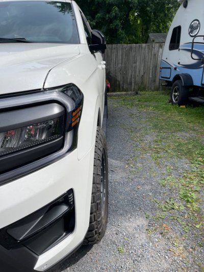

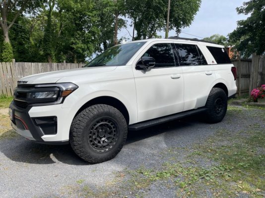

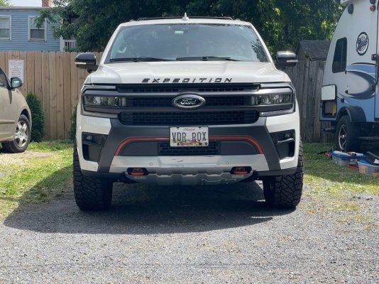

Thought I’d throw mine up as it sits now. No lift on 275/65r20 (34”x11”) Nitto Terra Grapplers with F150 wheels and 1.5” Bora spacers. Without spacers, these fit with zero rubbing. Spacers required the front liners ahead of the wheels be pulled forward slightly. Tires poke just slightly with the spacers. Will run this for a bit but did find a set of raptor wheels…
