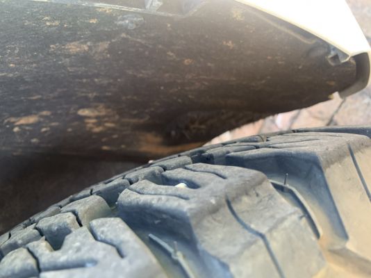

5100’s, 5star tuned, 275/60r20 wildpeaks on procomp +6 offset, powerstop cross drilled and slotted rotors with ceramic pads, K&N drop in. Upgraded intake and intercooler coming soon

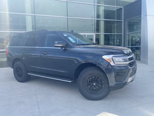

Iexpo black rhino.jpg20211206_072621.jpgI I just traded in my stock 22" wheels and tires (which in my experience were minimally capable in snow), for Black Rhino 22's and some tires with more meat on them. I wanted more capability and slightly more aggressive look without going for the full off road look. Ultimately i decided against suspension mods at this time. This expo will see plenty snow, but nothing off the road. Very happy with the outcome. NO noticeable difference in ride or tire noise, no rubbing. On 22's I believe this is as large as you can go without mods to suspension.
Specs:
22" Black Rhino Kunene 9.5 30 (i think)
Toyo AT3 305/45/22

This looks great! I'm likely going with the 305's on my stock rims when my Hankooks finally give out (which is soon). Looks like it fills the wheel wells out a little more and provides a slightly more aggressive stance without having to mess with the lift.

Won’t the 305 contact the upper control arm on the OEM wheels? I have the 20” and will be sticking with the OEM, but it looks/feels like 285 may be max width (depending on tire). I have 5mm spacers already, so could probably go 295. Iow, you’ll need more offset to get the 305 tire, which a new wheel will provide.

Based on what I've read in other threads, there's been no rubbing in most cases with one report of minimal rubbing at full lock in another. Sounds like if you want to be ultra conservative, you can go with a 305/40/22 instead of a 305/45/22.
