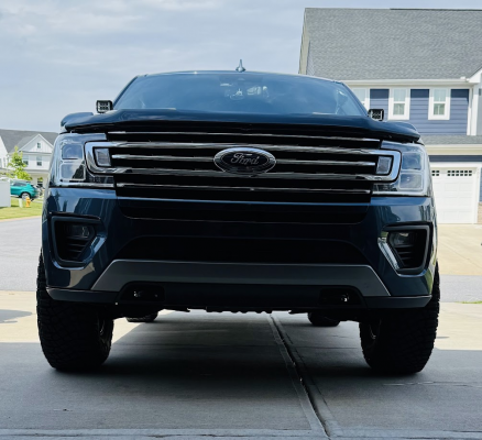

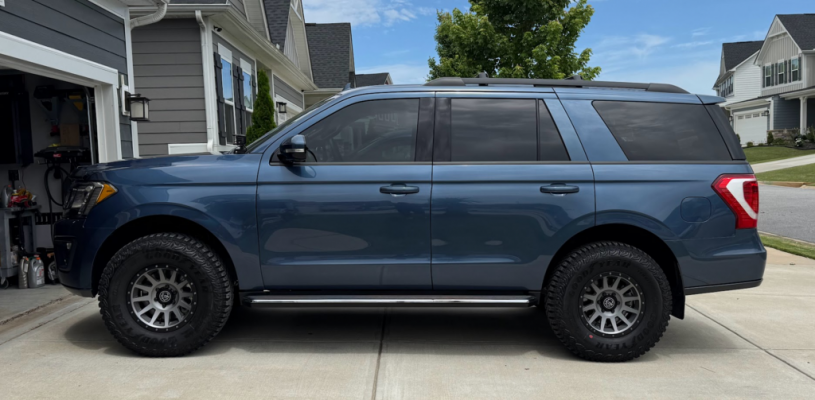

Finally got around to completing the lift.
Front: Bilstein 5100 F-150 4x4 bottom ring (24-248129).
Rear: Bilstein 5100 Expedition shock top ring (24-285063).
UCA: JBA (
https://jbaoffroad.com/jba-upper-control-arms-for-ford-f150-2004-2020)
LCA: SPC HD Raptor Alignment Cams 86252 x2
Wheels: Icon Vehicle Dynamics Compression 17x8.5 ET +6.
Tires: Goodyear Wrangler Territory 315/70R17 (C Load / 34.4"OD x 12.7" / 52 lbs)
Does it poke? Yes a little.
Does it rub? Surprisingly no. Have caster alignment pushed a bit forward. I might be able to reinstall the WeatherTech mud flaps that I took off just before install - *Edit* - They still won't work with the sweep.
The UCAs are just touching the springs at full droop. The CV boot will also slightly rub LCA at full droop as well. Given collapsed and extended lengths of these shocks vs the 2wd F-150 version or Expedition shocks, I would possibly explore the 2wd F150 version if there is a next time as to not over extend the components. Main thing is the half-shaft CV doesn't have any bind (been there before in past builds).
Rear end still looks good to me. The rear axle pull towards the front is actually not that bad (to me). So I'll also probably forgo the RC arm kit. A more aggressive lift (2" and more) with either spacers alone or combo'd will pull it to where I'd need that.
Rides very good. Not harsh or floaty. As comfortable (to me) as the stock setup with more planted feeling. I already have the HD tow pkg which I can say have different springs and struts than non, so maybe that already set the bar of what to expect. I love the look and stance that I got from this setup with the way the tires fill the wheel wells. Truck looks like it now lives up to it's name.
