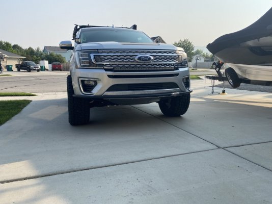

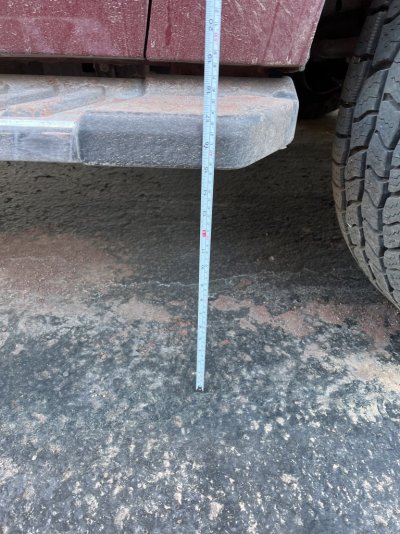

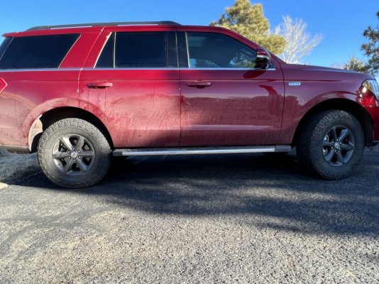

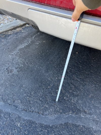

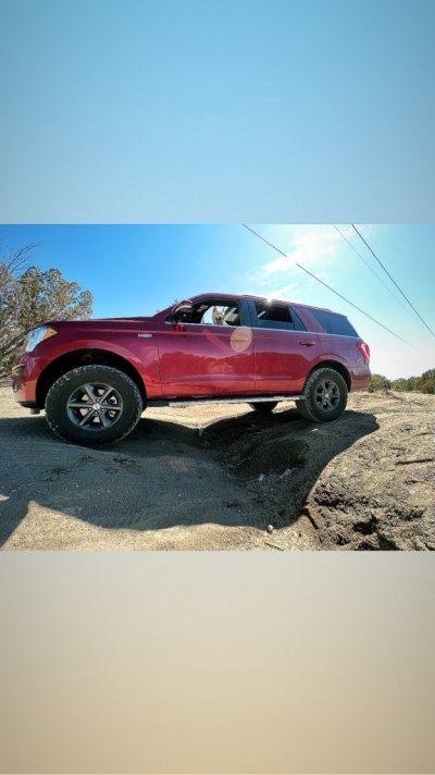

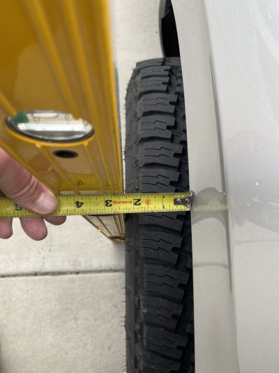

Bought the bilstiens - f150 fronts expy rears but now I’m not sure if I want the full 3” up front. Took the tires/wheels off my old expy play around a bit. Debating waiting for the new 295/70/18 BF Goodrich KO2 to come out in a few months
Stock 2020 FX4 with HD tow
275/70/18x9 +18 offset
KO2s on method 305s
no rubbing and plenty of room even when stuffed. BBF9E882-0561-4A58-8A78-FB09A01F92A2.jpegFF3D09E9-6773-4F83-BE94-FF707136F403.jpeg

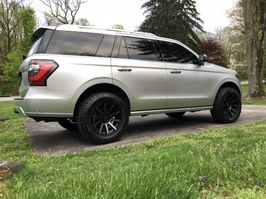

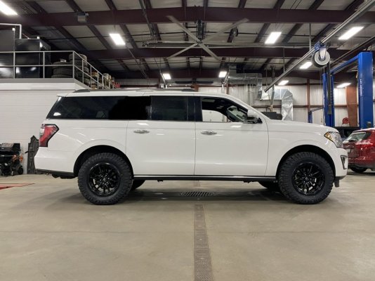

Just finished the 3/2 lift with new 20” Fuel wheels with -18 offset and 275/60/20 Mickey Thompson Baja A/T’s. Zero rub and zero trimming. Still looks pretty big & aggressive for an expedition. Chrome delete starts this weekend…wish me luck.
What are your highway MPG’s below 70 mph? Love the look!

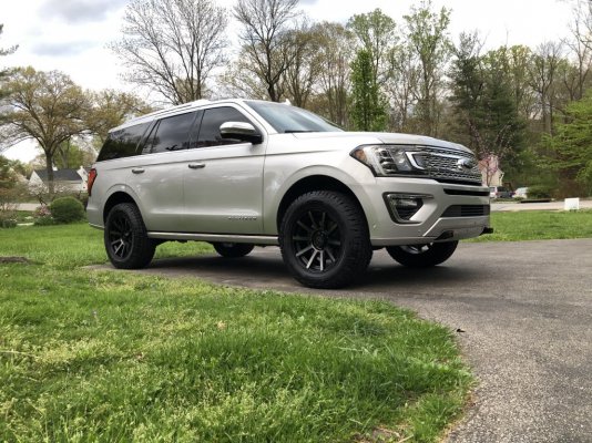

2019 On 295/70r18 Nitto G2’s with 2021 F150 Fx4 wheels and a 1” spacer.
Right now it has a 1.5in spacer in the front, but I have F150 Eibach fronts and Expy Bilstein tears to go on. Just content for right now so saving them for when the complacency runs out.

Very nice. Did you have any trouble fitting the wheels? 295/70R18 is 34.25" - any rubbing issues?
