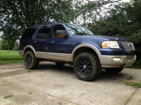

It appears that the same Ready Lift spacer lift Kit for the 3rd Gen trucks fits the 2nd gen as well. 33-34" tires are probably doable without too much issue, but I suspect you will need to watch the width and wheel offset, like the third gens. The Rear IFS is a different design in the 3rd gens, but it still uses a strut style spring/shock assembly and the spacer lift kits just sit on top of these.
I was surprised not to find a Rancho Quicklift product for the 2nd gens, guess the lower mount is significantly different, and the economics of scale didn't make sense to Rancho..
Here is a 2nd gen forum thread that may be of some help (maybe you have seen it though)..
2nd Gen on 35s with 3" lift
2nd Gen Lifts have certainly been done..
