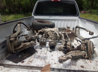

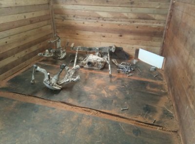

I just found a power trax spool used for a month till truck was written off. $200 CAD 28 spline for our front diffs.
Gave my buddy first dibs, but if it's still for sale after I move I'll grab it.

Dont spool the front. You'll never be on pavement again. Even the dirt will suck. Lunchbox or air lock the front. Spool the rear if you want but get ready for wheel chirp and tires

Pretty sure the axles will be ripped to shreds after the first turn with a spooled front.

I guess it might be a little more heavy duty than stock parts on 37's would probably like.
Got some plans for this thing that I don't want to be that moron that makes a list then does none of it.
That being said after the lift we'll have to see how tough the 8.8 wants to be.

Well mini spool, more specifically.
Issue is the 8.8 carrier is one of tne weakest out there for tolerating abuse, so I'd need a stronger carrier at least, then hit up rcv for outters and inners, then truss the axle...
At that point should I have gotten a D44? Lol

I thought about a 9.75, but if I'm swapping axles I'm going to swap in a 10.5.
As it stands artec makes a 8.8 truss that can beef up the 8.8 pretty cheaply, and eliminates it's biggest weakness as well.
As for the front axle, I have a few ideas but until it's out on the floor when I do the lift it's all speculation. Mostly just beef up the stress areas. Might work, might not.

And this was not the weekend to cross over the border.
That being said the guy was happy to sell it, he rolled his truck two separate times and it was taking up space.
To be neglected for weeks.
