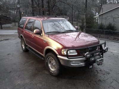

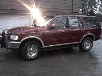

here it is. Its really in very good shape, paint looks great interior looks brand new.

Lightnig
Jan 23, 2013
709
91
Behind you
I bought it. Just got home with it. I will upload a pic as soon as it stops raining. The trans code on the door jamb is "E" and the axle code is "H6". Do I have the r100 trans and 9.75 axle with 3.73 gears? From what I can tell I think thats what it has.
Ford Expedition Gear Ratios
I believe you are correct.
Yours has the same codes are my 97, which has the 9.75" 3.73 Limited slip and the 4R100 trans.
If you lant to verify the rear end, crawl underneath and check the tags attached to the cover. The size is easy enough to verify just by looking at it, the 8.8" is oval with 10 bolts attaching it and the 9.75" is more teardrop shaped with 12 bolts...
Lightnig
Jan 23, 2013
709
91
Behind you
by the way, I like that grille guard a lot, have you figured out what brand it is?
And looks like you have the same winch I do too...

XPED4X4
Feb 11, 2013
Moody, AL
I havent even checked to see what it is, I will look tomorrow and let you know.
Thanks for the input guys. Now im trying to figure out if it has the tow package. I looked behind the grill where the ac condenser is and I didnt see a trans cooler but that it is when I noticed a big dual tone air horn++. I didnt think the exp came with this trans and rearend without the tow package,
