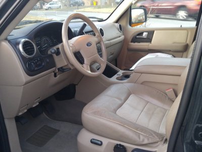

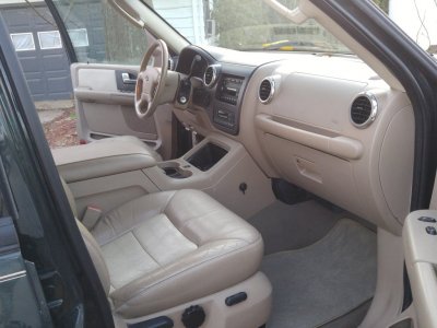

I bought this '03 EB edition 5 years ago for 5K with under 150K. Tranny died at 177 but the truck was very nice. You can find a really nice truck...but be careful for frame rust. I used to launch my boat with my '99 and the whole rear rusted to the point that the show towers rusted through!
