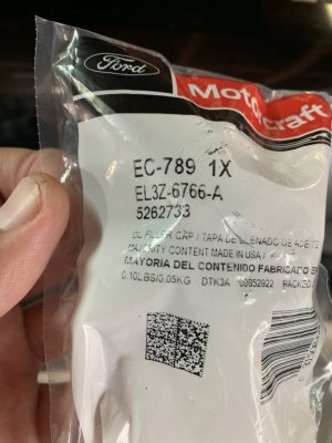

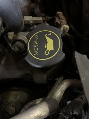

The decal hasn’t arrived yet. The 5W-30 oil cap came today. It does fit. It’s the exact same cap, just different lettering.
Motorcraft EL3Z-6766-A
I’ll put a pic of the package.

Yeah, it fits the 3V motors, they have the quarter turn lock tight. The 2V motors have complete threads and a click tight system. It won't work on the 2V motors.

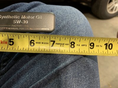

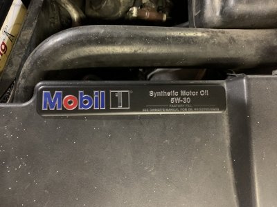

The Mobil 1 emblem came today. I assumed it was vinyl but actually it’s a true reproduction of the original Corvette emblem. It looks to be aluminum coated black, raised lettering, with self adhesive strip on it. I wish it didn’t read “See Owners Manual for Oil Requirements”
I might black that out before I install it. I’ve got to clean the radiator shroud first. I found an acceptable spot. Wish I had the engine cover so the label would be right above the oil fill cap.

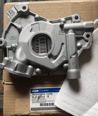

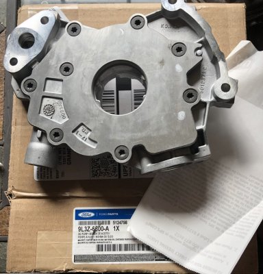

I’ve been back to the factory recommended 5W-20 after I did the new oil pump and tensioners. I did run 30 weight when i had rattles though. Then again I used the Ford oem oil pump again his judgement too...aluminum backer plate and all. Been running great rattle free since I did the work with the OEM stuff.
