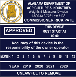

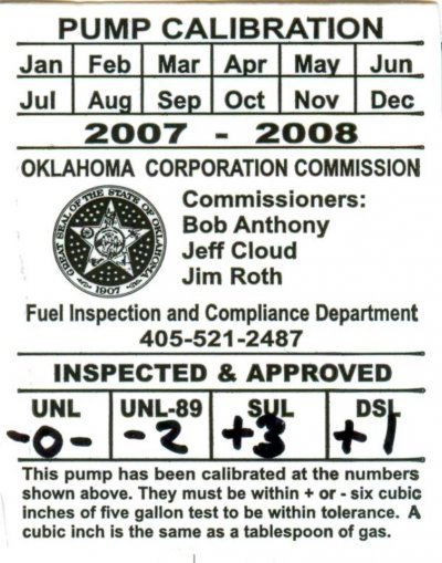

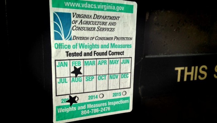

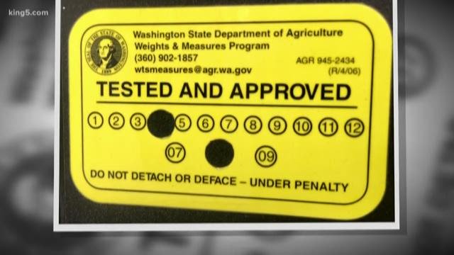

Where I live the state weight & measurement dept. TWICE yearly checks each and every fuel dispensers.
There are 231 cubic inches of liquid in a gallon.
With a 5 gallon test can, plus or minus 6 cubic inches of fuel is the allowable variance.
6 cubic inches is equal to roughly 6 tablespoons or 0.03 gallon.
Over or under the 6 in^3 the station has 24 hours to repair. Pumps that exceed +/- 19 are locked down immediately.
I'm pretty sure every state works similarly.
