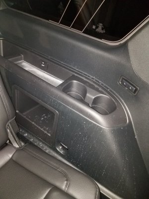

Any idea what could have caused this? I doubt the vehicle was like this when I purchased this. I just took possession last week. This is one both sides of the third row. It appears to be water stains/spots. The seats and floor seem to be fine. It had been raining a lot last week and I drove thru some and also had it parked outside for a few hours. Could there be a leak somewhere?

Sure the rear vents did not get left open?
Though that sure is a lot of crystallization for just rain water. The rectangular cubby is almost completely crystalized.
I would sit back there while in a car wash. Check the headliner. And the seals around the rear window.

What are you exactly referring to when you say rear vents. Do the side windows open?

OP: Somebody once left their restaurant leftovers in the car. A few days later it was discovered.... I went overboard with the Febreze and it left a similar, shiny spot residue mainly on the plastics but nothing on the leathers. So, I wonder if your dealer maybe used a similar product, maybe one with a malfunctioning nozzle?

Looks like a seat/vinyl cleaner that was over sprayed and not cleaned off because it seemed just wet but once it dried later left a residue however it is an odd pattern for a spray nozzle and there is nothing on the seats. Have you done the car wash yet?
