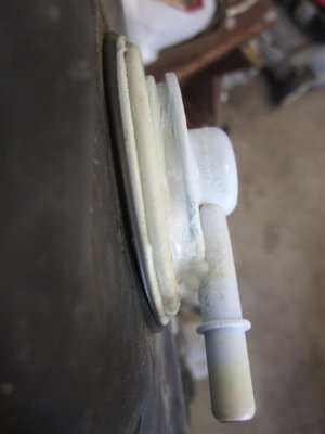

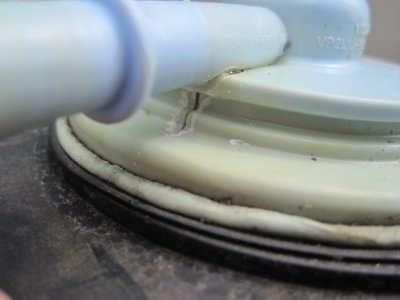

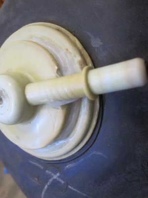

The included photos show one of the vent failures and the plastic welded repairs mentioned earlier. They are rock solid HDPE which is the same material as the original vents. I will be pressure testing the tank over the weekend and will post results, but fully expect to have a permanent repair to my fuel leak.IMG_1852.JPG IMG_1858.JPG IMG_1858.JPG

SUCCESS! The welded areas all held pressure OK using the soap bubble detection method. I only tested at 2 psi because the vents both opened at about 1/2 psi. (I had a balloon on each vent to observe that they were working OK so I removed them & installed rubber caps) I figured 2 psi was 400% of what the vents would ever see, and I was unsure if excess pressure would do any harm to the internals.

Great job! What crappy materials. Truly defective stuff. I'll bet every one of them will fail that way given enough time. Lots of work pulling the tank and finding that crack.

Thanks, Trainmaster. Yeah - while researching I've found several other posts with this same problem, and they seem to fail in different ways. Hope this process helps someone else.

I think the issue with spot surface fixes of the cracks - it just makes new crack in other area and the problem repeats. I tried JB Weld and at first the cracks were on the top of the vent, but after fixing the top the new cracks appeared in usual location under the connecting tube. After fixing those new the second time - the OBD EVAC test completed in 30 miles trip. But later I have to disconnect the battery and noticed the EVAP test is taking a long time and sure enough I found new cracks in different spot with endoscope. I am thinking to model 3D sleeve over the valve, print it from transparent nylon and then glue it over the vent with structural adhesive (like 3M panel bond). It should solve the existing cracks and future ones that would not have any impact on the leaks. What a mess, lol

Just some thoughts on vent repairs after inspecting used tank from salvage yard:
1. the tank material is HDPE
2. the vent quick connect tube male end has an inner tube insert to guide the vapor that looks transparent and flexible and probably is HDPE
3. the vent itself is most likely made from nylon as are most plastic quick connectors. HDPE is not suitable for quick connects, it is just too flexible and too soft. This would be true for fuel lines, but vapor lines are not as demanding, so HDPE is a possibility.
4. the crack may appear on top (tiny cracks) or below quick connect tube (big one), but it also affects bottom of the connect tube. It is hard to see from side or above as you may not want to flip the tank over for safety reasons. So basically the lower crack is symmetrical U-shaped.
The fact, the vent itself most likely is not made from HDPE may explain why epoxy and other adhesives not designed for HDPE are working as "good enough" for most cases. But for plastic welding the nylon rod may be a better match. If you do not see the cracks on one of the vent or no cracks on the top yet - those could appear next as by fixing visible cracks on the cracked vent you will move the weak point to other vent as pressure will be restored. So as preventive care it may make sense to cover all vent surface with layer of 3M Scotch-Weld Structural Plastic Adhesive DP8010 or use DP8010 to cover the cracks and the rest of the vent surface if you do not want to weld plastic for safety reasons. The welding should be safe as fuel vapor will ignite with open flame or spark, welder temperature will not ignite the vapor.

I did non scientific "finger nail scratch" test on the tank and the vent and it is possible the vent is made from HDPE as it is very low pressure lines. It may explain why it fails in area with deficient material during injection molding. Nylon would be very difficult to scratch though.
