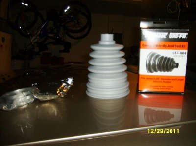

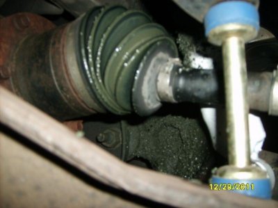

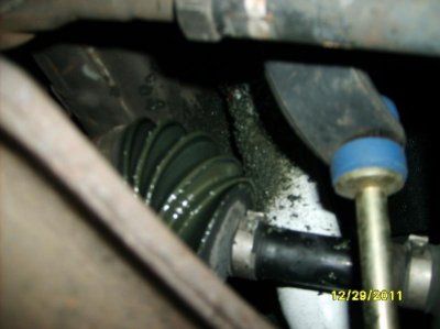

Well I was driving home today from work and I was hearing a squeeking noise coming fromt he front driver side and thought it to be odd. When I got home I further searched the underneath and what did I see, grease, grease everywhere. The inner CV boot was torn and spewing and flicking grease everywhere.
So I went to the auto store and purchased a make and model specific inner CV boot kit for $25.00. Looks as if it is parked until this weekend when I am able to get to it and pull the shaft out and take it apart to install the new boot and re-grease it.

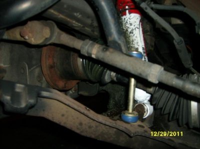

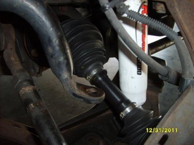

Well I purchased a new axle today instead of just relacing the boot. Did not make sense doing that as I still needed to take out the shaft to do the boot. And also trying to fit the boot over the CV knuckle. So for ease and time, and only 20 bucks more than the boot itself, I replaced it today. The only PITA part about this job was the clean-up of all the splattered grease that was from the busted boot. Man, that grease was everywhere. The sway bar was disconnected to get the shaft out, and was reconnected.

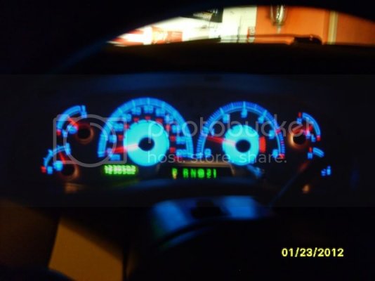

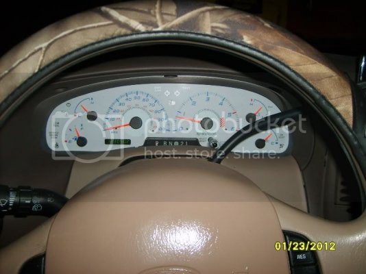

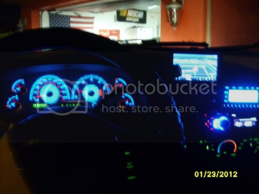

Well I was having problems with a intermitten odometer going in and out on the digital display. So tonite I finally went and took the cluster out and took it apart. I found a cold solder joint on one of nine prongs going thru the mother board that control the digital odometer display. I re-soldered it and while I was at I went ahead and installed a white indiglo cluster overlay. After it was all done, it turned out pretty sharp. As you can see also in the pics that the odometer is working again as it should.

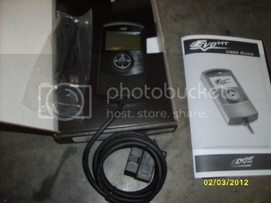

Well I got the tuner in today and I installed a tune called 87 octane. After I installed the new tune, I took it for a test drive. I programmed it for the 33" tires and firmer shift points. I could not believe the difference with that tune. It takes off like it has a purpose, shifts much firmer, and the speedo is correct along with proper RPM ranges. Even at cruising speed, a partial throttle will cause the truck to take off quickly. Before the tune, the engine lagged at throttle response and required almost if not all throttle allowed to get it to take off when needed. No longer is that the issue. I am so happy with this EVOHT tuner it is just unbelievable. Money so well spent and there is 4 other tunes to use under the advance tuning. One of them is called Extreme, and I can't imagine what that will do after just using the 87 Octane tune. I recommend this to all that is looking for performance in the palm of your hand. It is alittle pricey at $400.00 to your door, but damn, it will pay for itself with fuel economy.
