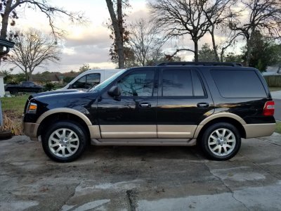

Guys, I have some strut assembly questions. Just installed Moog front strut assemblies (part number st8598) in my 2011 Expy XLT. It looks like the lifted the front about 2 inches. Will these settle? I don't think I can live with the "lifted" front end. These would be great for the 4x4 guys though.

2 inches is a lot. Doubt they will settle much.... the spring decides the ride height, not the shock.
Edit: are you sure the vehicle has not been lowered, possibly before you took possession of it?

I looked at it on flat ground... It's not as bad as it looked in my sloped driveway. It also may have settled a little since I installed them yesterday. I just really don't want that lifted look.

I'm going to give these springs a couple weeks to settle but I don't think it will settle enough. Then I'm going to order the Bilstein replacement struts and rebuild the originals, install them and send these Moogs back.

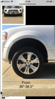

First time uploading pics...
You can see the huge gap in the front wheel well.
Well yours looks like mine after I did a 3” spacer up front and 2” in the rear
One thing to remember though is that those assemblies haven’t seen any pressure on them since they were built and are probably going to take some time settling. That does seem like a huge gap though. Keep an eye on those measurements.
Really! I was thinking this whole be a good lift strut for a 4x4.
If anything though.... I would've wanted the front lowered an inch.
