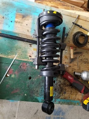

That's said, I decided the best thing to do was order spring compressors from Amazon for $28 and swap the Moog spring for the oem springs I removed. It worked perfectly.
The Moog springs were only a half inch or so taller than the oem springs (Moog on the left in the pic). They were much stiffer though and raised the front of the expy 3 inches! I think these were 4x4 springs but they weren't marketed that way.
The front is 3 inches lower now and the ride is much softer.
