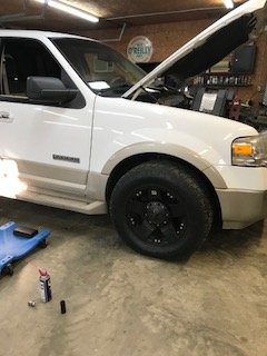

I put some 18x9 rockstars on with 305-60-18 nitto terragrapplers.

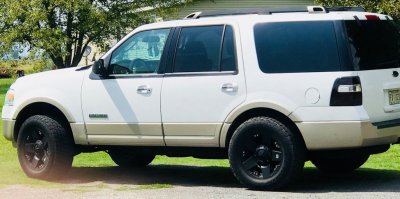

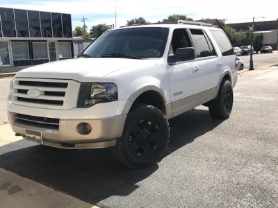

Lift is on! i used the rough country 570 on the front which is 2.5" and a generic ebay 2" rear. Next is black housing headlights!
