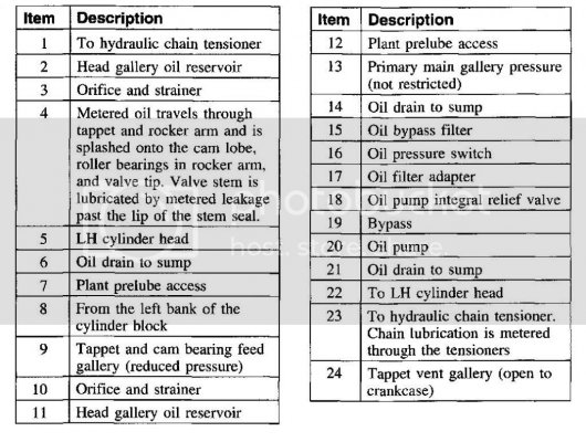

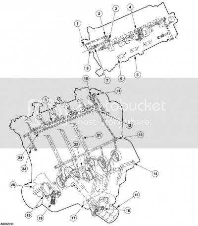

From experience, more than likely you problem was induced when you did all that maintenance. Maybe you pulled an oil galley plug or something like that? Maybe the new gasket has a plugged path that the old one didn't.
