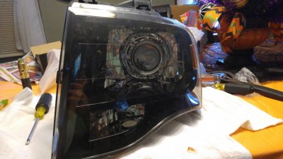

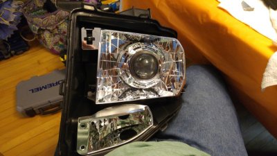

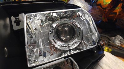

Id strongly recommend a retrofit if you don't mind spending the money. Pleanty of budget options for under $200 but much better options at just over $300 if you wanna attempt it yourself. They will out perform any hid/led in a reflector housing and any aftermarket projector housing. Check out theretrofitsource.com

Here's the ones I did on my 07. Worth every penny!

Retros work and cost less than $400 if you do the work yourself. Get a threaded shaft projector and it's easy stuff!
