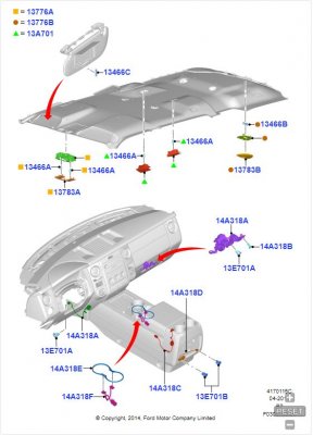

Would anyone happen to know the US part number for this ambient light harness ? This is for the center console
I see the part number right there but when I search on google nothing comes up.
FL14-14D662-AB

I believe I found it, ... the little voice in my head kept bugging me, couldn't wait until Monday to call Tasca
Punched the original part number in parts.ford.com and it came back with the base no. 14A318
Clicked on related parts and it showed the diagram with all the ambient lights; the center console is 14A318C and then cross-referenced that with Fordpartsgiant.com and voila !
FL14-14D662-AB = FL1Z-14A318-S
