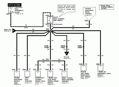

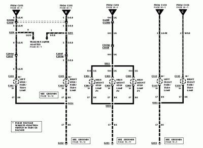

From the sounds of it Your Multifunction switch is bad
The power for the brake, turn and hazard circuits all go thru the Multifunction switch
I will up load the prints you need, shortly
Bedrck47
Jul 4, 2014
5,639
659
Elizebethtown, PA
You would want to check to see if your getting voltage at Points A and B on the first print
Being the drivers side is working I would say you have voltage to point A
When you press the brake switch you will have voltage at point D
follow the line from point D to points A and B
Its all in the MF switch
