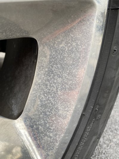

Got these for my winter setup. New OEM Ford aluminum wheels (22”) with Blizzaks.
One month, and one snowfall later, this is how they look.
Who designs and manufacturers such prima-donna wheels?
I’m assuming the spotting is from salt. First off, I thought aluminum is non corrosive. Second, why design wheels for a truck that don’t maintain their appearance after a single month in winter?
I’ve had aluminum wheels in our Acura and Volvo and they never stained like this after years of winter use.
WTF is going on here?
Sorry fellas, just venting. I can buff out the spots with aluminum polish but who has the hours to spend on this?

So, an update. I don't believe these are genuine Ford wheels. They appear to be replicas. I got them from a top-rated eBay seller with 100% positive feedback, and 5-star ratings on Google and TrustPilot.
Still, for $1300 for a set of four new wheels, there is no way these are genuine OEM wheels.
Probably Chinese knock-offs (even though they have the Ford part# stamped on them).
Our 2018 Expedition came with brushed aluminum wheels (which I use for my summer setup), and 3 winters in, those wheels are not showing such spotting at all.
So, as others have remarked here, these are probably uncoated Chinese knock-offs. Kinda makes you wonder, why cut the last step and not clearcoat them?

Actually...I’ve bought Ford wheels off eBay from trusted sellers, and several times they were OEM that were ‘refurbished’. Meaning...the seller got them in used condition, and then spent time polishing the crap out of them to make them look shiny and new...but in the process they polished the clear coat right off.
Several times I’ve had to either clear coat them myself or just keep them away from salt as much as possible because they absolutely showed corrosion within days. (Just like your picture)
Unfortunately i also found this out the hard way. Those resellers mean well...but their priority is making them look new and getting us to buy them. Their polishing process gets them shiny! But it removed the clear coat that protects them long term.

Ideally aluminum used as brightwork on a vehicle should be hard anodized *and* clearcoated, or at least hard anodized. Ford used to used anodized aluminum in the 1970's when they started using soft stamped aluminum for trim. Highly polished aluminum sheet was used, with dies that wouldn't cause scratches on visible areas. Dunno if the anodizing process was before or after stamping, but the stuff is so soft if the anodizing gets scratched it's impossible to get polished to look good.
So if you want the wheels to really stay looking good, see if there's a plating shop that also does aluminum polishing and anodizing. They would mirror polish, chemically clean, then anodize. During that process they could be colored so the color is embedded in the aluminum oxide coating. Then they could be sprayed with a super tough clear urethane.

Well, just an update. eBay refused my claim, stating that the posting was "OEM-spec", and not OEM genuine. I should've known better. Probably a seller that works with a Chinese factory that makes impostor wheels based on OEM designs. Probably scan them with laser and copy them down to the smallest detail, including Ford Part# stamped into the inner rim of the wheel.
No sweat. I paid $380/wheel, vs OEM being $1100/wheel. Should've known there's a catch.
