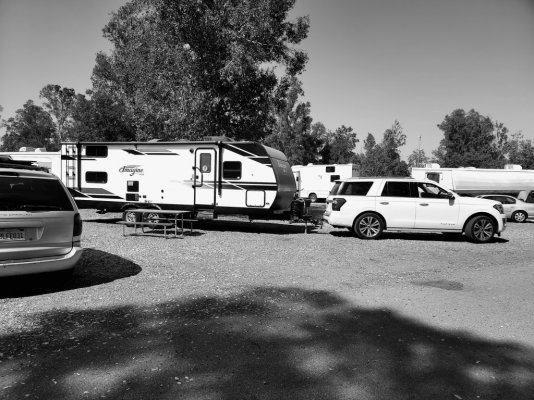

Well it just so happens on the way to the campground. Expy had about 600 lbs of people and stuff plus trailer. We also had a ton of water because the campground only has electric. Only the second trip but wd close to being dialed in.

A 2400BH is a fantastic trailer, we figure the kids are small how and we have 6 years of small people before I don’t think this set up would work unless we took two cars. Which is totally doable as well.
Thank you, Sir. Even without knowing your actual weights without the trailer hitched that helps. I think you’ve hit the nail on the head with the Expy only carrying people and little else.
We only have a couple of years left with our son wanting to join us. He’s also built like a string bean, so that helps keep weight down in the Expy ourselves as we’ll be carrying some cats with us on our adventures.
Thanks!

Yeah we literally have 800 lbs left of payload in the trailer. This day in age all the kids in the car just need there entertainment, which is relatively light. We throw the canoe on top then put all of the canoe stuff in the trailer for transport to the campsite.
