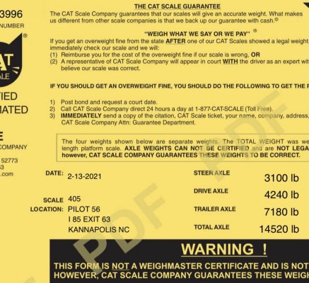

    Your best bet is to load it up as if you were traveling and then take it to the scales.
    If it not busy, I would do one of just the Expedition loaded. This will give you an idea of the axle weights before the trailer is attached.
    A second with the trailer connected. This will give you the tongue weight because you will see what the additional rear axle weight is.
    Either go before or after with just you and your Expedition empty, but in your normal daily driving configuration (keep everything you normally have in your glove box, center console, rear area). This will give you your “updated” curb weight. You can use this new value to calculate your “new” payload value (GVWR - Curb weight = Payload).

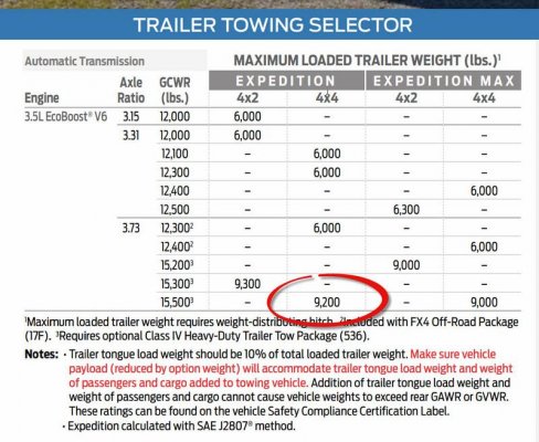

    Two adults and 2 kids here. Also shopping ideas. Beyond the payload challenge is our experience with camp availability especially today where we have dropped a camp trip for an airbnb because the # of people RVing and car camping today has exploded no availability anywhere. . My current setup is a 4x6 trailer 12ft long. Our plan to upgrade has been put on hold given we wouldn’t be able to use it if we wanted to use it. Plus my max is 19ft so we can / could still easily fit in National Parks etc. For us the max tow Expedition was chosen for a few reasons not just the 9300lb. I predict a severe post COVID RV crash especially at the storage fees I’m hearing about along with pretty much zero availability for sites unless you book 6+ months out. Trailer size can be a big negative in where you can get a site especially today.

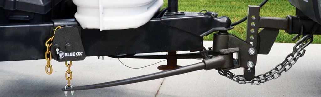

    We tow a 2800BH Grand Design. It’s 32 feet long and GVWR is 7995. Listen it’s big but the sway isn’t bad at all. People throw out so many numbers at you and percentages to stay under but listen the numbers don’t lie. Payload is where you run out. We pretty much max out our limited max with the family and the trailer. You have to be careful of your tongue weight because that directly eats at your payload and provides stability while towing. Out of the factory it was 630 tongue, but life’s up I’m pushing 800-900. Those front pass throughs have so much room in trailers this day in age but it is a balance of front and rear weight to balance younger weight and stability. For instance, if I put something really heavy up front I tend to balance it in the back. Then it’s an estimation game of about 11-12 percent tongue weight. I do utilize a curt better weigh Bluetooth scale. It works great and the math doesn’t lie. Still tweaking my hitch but my 4 point equalizer has 8 washers to transfer weight to the front and weight wise it is very balanced.

    I know this is Fizzy’s thread; have you weighed the entire setup at a CAT scale? Curious to see all the weights. We’ve been looking at a 2400BH to keep both length and weight down.
    Thanks in advance.
