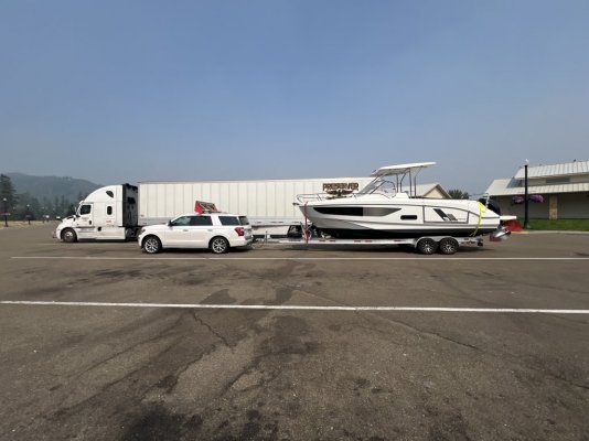

IMG_8922.jpegIMG_8922.jpegSeattle to Tahoe 9000lbs 13ft high, 9ft 9 wide 34ft hitch to props. 9.5mpg
Your trailer must be really draggy or your going 80mph
I can't make one out in the photo... so just in case... you really need a WD hitch at that weight. It's stipulated as mandatory in the manual for towing more than 6000lb.

Wdh is for RVs boat trailers are setup differently been hauling trailers for a long time. So yes your right google says….. No your incorrect given the trailer application is not a RV.

Nothing to do with Google at all.
Whilst I trust that you’ve done it many times, the Ford manual disagrees with you. It makes no distinction between any load type; RV, boat, or otherwise. This is what the Ford manual for your vehicle says:
“You must use a weight-distributing hitch for weights above 6,000 lb (2,721 kg), up to your vehicle's maximum towing capacity.”
