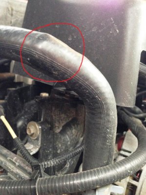

I read things on the blend door being stuck or broken leg, but when I change the temp from 90 to 60 using the manual temp control I can definitely feel the difference of the cold air coming in and then back to warm when I go back to 90. I can feel it as I gradually change the temp or do it more rapidly. Lines are all hot (can touch and hold them just fine) but hoses don't have any pressure to them to me. I squeeze the upper radiator hose easily and it makes the level in the degas tank move a little with NO BUBBLES. I squeeze the heater lines and they feel hotter than the radiator hose but almost like nothing is in them, no pressure. Not sure if they did before or not because I never had this problem before.

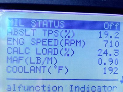

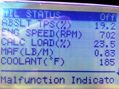

Today it is 38 degrees and I have a temp gauge saying I have exactly 90 degrees coming out the defrost vents but to the touch it doesn't feel it and its not enough to melt any snow or ice off the windshield even after running the car for almost an hour. Today there is no ice so can't test it really but the colder it is outside the less heat is is inside. Its barely warm when it is 5 degrees but its not ice cold air coming out of the vents, its just barely warm and barely enough to take the fog away on defrost.

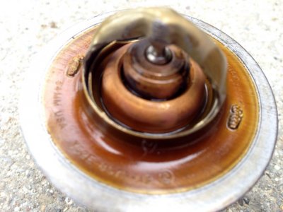

I've read about bad water pumps and air in the coolant system but with metal propellers and no overheating and factory idiot gauge within the norm I doubt it. Same thing with a suspected thermostat I think I would be seeing something even though its just a factory needle gauge if it was stuck closed. I don't think it is stuck open because it would take almost forever to move the needle gauge to normal range and probably would be less than normal.
Any ideas on things I can do to check? There is no heater control valve, just a blend door from what I see and read on the web. So what tells the coolant to flow through the heater box and into the heater core? Fans are blowing, air is moving, its just not very warm. I can even stick my fingers in the degas tank as the coolant after just now running for an hour and a half is only 91 degrees. Is this just the engine temp warming it up being just an overflow tank or is it suppose to be as hot as the radiator and flow in and out and I'm suppose to see it turning up every time the thermostat opens up?
Heater lines feel hot like there suppose to but don't feel full and kind of soft. Ran the car with degas tank open for all this time (1 1/2 hours) and put a piece of tape on the level line (2 inches above cold mark and an inch from over flowing) and it has never moved unless I squeeze the hose. But when engine is cold it drops to just above cold mark and goes back up 2 inches when warm. Had the heat at 90 the entire time and I got in and it was just comfortable but not a sweat box as expected and should have been.
