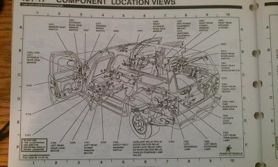

For my 99 there are two relays for unlocking the doors. One is for the driver door and the other is for the remaining doors. Both relays are located in the aux relay box #2 which appears to be located in the back driver side panel under the rear side window.
