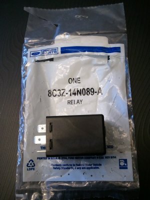

Powerfolding wasn’t always controlled through DSM, I don’t know at what point Ford made the change but there was a much simpler setup before.
This little fellow right here, OEM Ford Relay 8C3Z-14N089-A aka the Power Folding Mirror Module

The wiring book isn’t correct, Expedition Limited models have had Power-Fold mirrors standard since the 2004 model year
You're right! The 2009 brochure mentions it and it is indeed in the 2009 wiring diagram. I stand corrected! Post above now edited.
Powerfolding wasn’t always controlled through DSM...
Well, that should make things easier! Use this module instead of connecting to the DSM.
