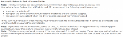

I WILL say that if you open the door on my 18 at any speed, the trans slams into park and tries to shear off the internal park pin. idiots!

I found this out when backing a trailer down the boat ramp. Mine slammed into park when I opened the door to see if I was deep enough. Stupid design. I now compensate and do not do this. Supposedly, if your seat belt is buckled, it will not slam into park. I always wear my seat belt, except when backing a trailer because I find it gets in the way.

Are you sure it actually slammed into park? The transmission is supposed to shift to neutral until the vehicle stops, then shift to park. The indicator will show park immediately. The slam into park is probably the parking brake applying which is what is supposed to happen if you shift into park with the vehicle moving and the brake not firmly applied. From the owners manual.
On a console shifter, when the ignition is
turned off, your vehicle automatically shifts
into park (P). If the ignition is turned off
when the vehicle is moving, it first shifts
into neutral (N) until it comes to a
complete stop. Your vehicle then shifts
into park (P) automatically.
The electric parking brake may apply when
you shift to park (P) without the brake
pedal fully pressed.

And just to reassure everyone your vehicle is not trying to kill you, if you open the door while moving AND YOUR SEATBELT IS ON, it will stay in D.
I just tried it.

@Deadman As long as the seatbelt indicator is not lit up on the dash you can open the door while underway and it will not slam into park. You can buckle then unbuckle your seatbelt and it won’t slam into park or keep it buckled behind your body when needed.

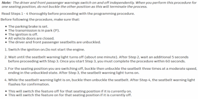

Curious if disabling the seatbelt alarm would have the same effect as being buckled in to bypass the auto-return to park when you open your door.11A73F8F-1A1D-42CD-AFC1-6169482EBB17.png
