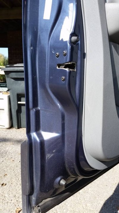

Wife sent a picture of the bumpers. They look to be intact and OEM. Maybe they've been compressed too long?

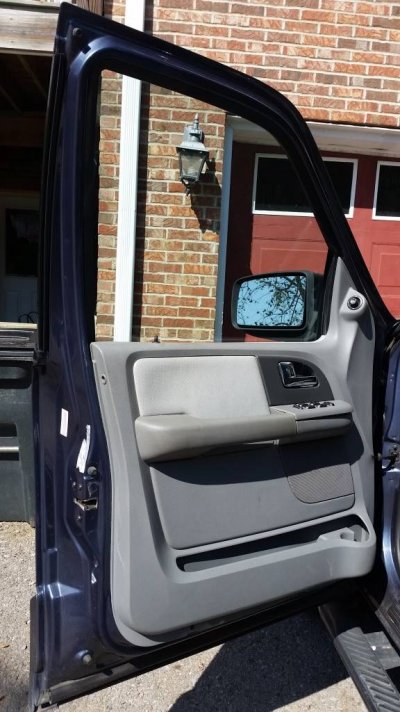

I know someone was meddling in the door. The expy does have an aft radio. There are amplifiers in the door for the speakers, but I removed the panel and secured anything in the door. When I shake the door with it open there's no noise.
When driving down the road you can hear the door rattling at the latch. It's a metal on metal kinda noise.
It's my understanding that the clasp in the door latch itself should have a type of plastic insulator around it. It insulates the metal to metal contact on the hasp on the B-pillar. My thought is that through the years of use, this plastic piece has worn through and fallen off. Anyone without a rattley door inspect the clasp on the latch and report back?
