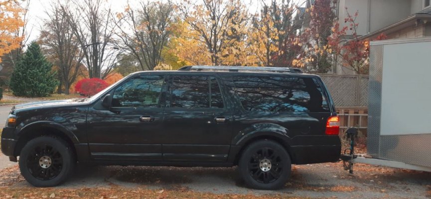

Hi ALL
I talked to BILSTEIN and they don't agree with 5100 for the 2012 MAX - they have 4600 regular non-adjustable.
Sooo... not sure how to proceed? Does anyone have the 5100 part number that will work for me?
PIC is my loaded MAX with trailer and the butt is saggy... it is 1" low when empty and when loaded, it looks whacky
I could use 2" lift and I found the STAGE3 company has a lift 2" thatmight work but it is a set 3" front and 2" rear
I'm asking them if I can get the rear only setup?
Please advise!
Cheers Clive

Try checking Ford part numbers for compatibility. If the part numbers are the same, the aftermarket part should work with either generation. Also, for the trailer, check the height of your ball. For my hitch, the top of the trailer ball receiver had to be positioned within 1" of the top of the ball. If the ball is not positioned correctly, you'll need a hitch that allows you to adjust the ball up or down as needed. It's difficult to tell from the photo, but it looks like the ball may be too high for the trailer ball receiver. If you drop it a little lower, it may reduce the sag.
