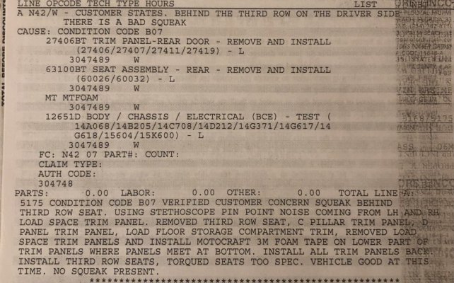

Below is my invoice which has a pretty good description. Still no squeak.7E0C5E42-81CA-4EDE-838C-40AEA26E50CE.jpeg
