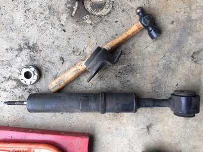

Just a wild guess... they may have put the spring perches on upside down. The perch should slide over the ring on the shock so that the spring is sitting below the ring (towards the right). If they put the perch on the other way, the perch sits on top of the ring and puts your spring a good 2 inches or more towards the left which would preload the spring quite a bit and the back end sits way too high.

A way to check is you shouldn't be able to see the spring perch extending below your shock. It should be tucked inside the bottom of the spring like in this picture.

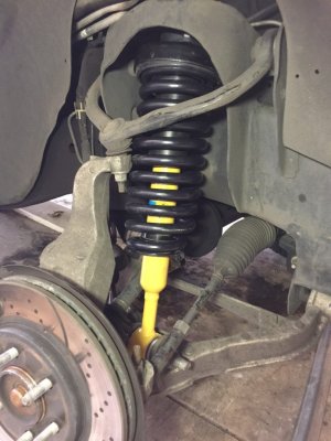

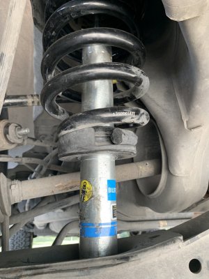

I forgot I had a pic on my phone. I think this is the driver side rear. My perches look a little different than yours. Does this look right?

Yes, that's correct. So perches aren't the problem.

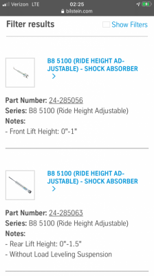

From Bilstein website. I searched 2014 XLT, and 2017 XLT, same parts for both models.

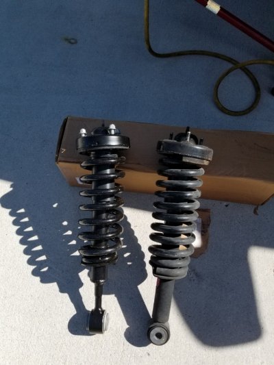

Bob what springs are those on your front end ? They look like the KYB springs I just took off. With the weight of the vehicle on the ground I only had about 1" of available compression travel before the springs were binding and bottomed out. There are so many coils there it had no room to compress. I went and got some Monroe Quick Struts for now. Much better ride. More like the stock new ride.
Monroes on the left, KYB on the right ....
