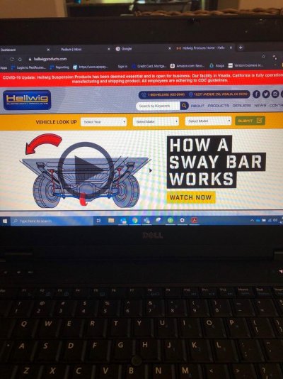

Anyone wanting a Hellwig sway bar, they are on backorder or delayed. I ordered 2 on 1-20-2020. I have yet to see them.. The distributor emailed me and asked if I wanted to wait or a refund. They stated they had received word from Hellwig there is a delay, and no given ETA on delivery. They are built to order and build time is 10-20 days. I'm still waiting on my other one..
TBaganATX
Nov 14, 2019
108
52
Buda
Did you order from Hellwig? I ordered from Suspension Connection...it was a bit cheaper.. but not sure WTH is going on if they gave you a ship date.. [emoji848]
