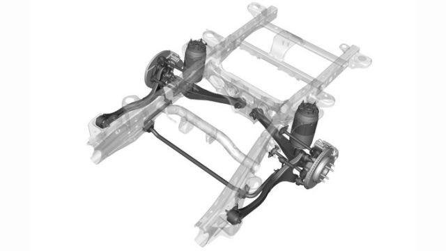

GM specifically added an additional link to their 2021+ rear Independent suspension because they noted this flaw in the Ford design and their additional link reduced it drastically.
I just can't tolerate the leaning tower swaying in the wind on the back roads.

You have already driven a 2021? I have not read a single word mentioning the new suspension design out performs the Expedition. The Expy has 4 links that are triangulated and the spring bucket arm. The new GMC’s have more of a trailing arm design with only 2 links and the spring bucket arm. Reminds me of a Polaris XP rear suspension. The tires still move in pretty much the same manner. Shock location would change the sway and so would the dampening and spring rates. But the Sway bar is the key. Stiffer bar will greatly help the sway, but you loose wheel articulation and can harshen the ride. The question is will it be better to do the front, back or both. I have the Sumo spring spacers to install this spring for dune and boating season to help with the sag. If the Elvis Pelvis Hips bother me to bad I will try the hellwig rear bar first. I may just order it before spring so I have it waiting.

Somewhere in GM's release they specifically said they fixed the design flaw of the Expeditions rear suspension by adding an additional link of some sort. They claimed the rear sway was almost completely removed. They weren't calling the ford out, but they specifically said they did this to reduce the slop the expedition has. They weren't kidding, because mine is really sloppy. Backroads are the worst because they are heaved and it throws the expedition all over. It tracks straight, but it slops the body side to side like its full of water sloshing back and forth.

Motortrend noted what deadman stated during the press comparison chevy did. They had press drive comparison with a high cty with air springs vs a ltd 302 expy in a route that chevy determined. In it they stated they felt similar over smooth roads and broken pavement but the chevy had a more gentler, stable feel on backroads. I would say the stableness would be more due to the springs, and ford put very stiff springs on the the 4th gen expys and the dampers are fighting the tight spring rates. The versions without ccd dont heave much if at all and body control is a bit too good if you ask me. On back roads outside the lean, the back of the truck is glued with no bobbing or rocking, but your sacrificing a lotta pavement compliance, the back end bucks around alot on bad pavement. My nav with air springs had a much better rough road ride, though the expy had a better overall ride. I cant find the article now but i copied the link to it in one of the threads here back in dec.
