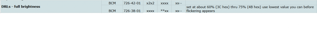

There is a way to brighten the DRL's with FORScan on the F150. I am not sure if this will also work on these, but worth a try. You can just revert back to whatever is there now if it doesn't work. I've had mine set to 75% for 2 years now with no issues.
