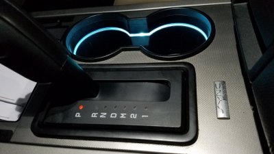

So a thin piece of plastic that surrounds the console shift lever and moves indicating what gear you are in, cracked into a bunch of pieces and I have an opening down into the console with exposed lights and an indicator stuck in 1. I ordered the replacement part for $35 and was quoted $250 to install it. Oddly, it's not a replacement of the plastic piece that broke, but rather the entire shifting mechanism down in the console including indicator and lamps (less the lever). Has anyone ever opened the console to replace this and how complicated of a job is this? Or should I just suck it up and pay the dealer?

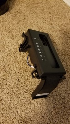

20180531_214007.jpg Thanks Eddie. I found a thread under the 3rd generation directory that detailed the same problem and a related YT video for an F150 that was helpful. Basically, it was (1) remove the bezel around the shifter, (2) unscrew one screw underneath a pad in the tray at the front of the console and remove the top part of the console including cupholders (the armrest lid is not removed) and unplug the cupholder lamps, (3) remove the shifter lever sides, (4) unplug 2 wiring connectors for the shifter (tow/haul button and up/downshift rocker), unscrew two screws (don't drop/lose them), and then remove the shifter, and (5) unplug the shift indicator piece (shift indicator lamps) and remove the entire shift indicator piece. Install the replacement part and reverse the process. Oddly, step one took the longest as I couldn't get the 4th prong to pry loose from the console and I didn't want to break it; applied some WD-40 and it freed up. Took about 90 mins and just saved $250.

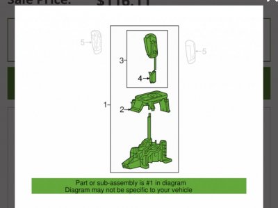

Where did you find the part? I can see it in a parts breakdown but can’t find it online anywhere.

Scott could you provide number of this item?
