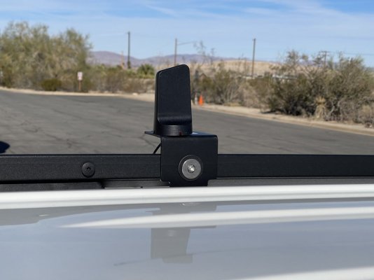

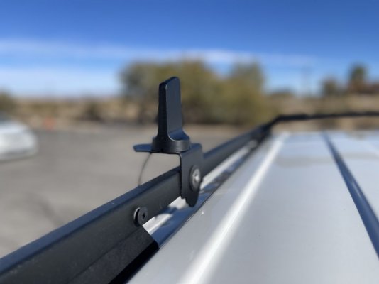

I needed a magnetic surface for my cell booster antenna. Found a galvanized black powder coated angle bracket from Lowe’s along with stainless screws, stainless washers, and rubber washers.

I have a Weboost Drive Reach device and its antenna is magnetic too. I just use the roof rail to attached it when I need to. Both rails are steel, at least on XLTs.
