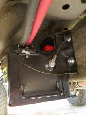

I remember that. I just don't think it would be enough room for this big a battery. I need to start taking some measurements. I'm now kind of leaning towards a frame mounted set-up. Something like this:

Thanks for the info. I thought that might be the case for the sides of the cargo area. That just pushes me towards the frame mount that I was thinking about. E350 vans had a pretty beefy set up like the pic I posted above. I'm going to start exploring that a little closer.

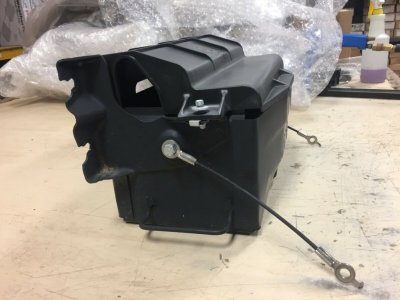

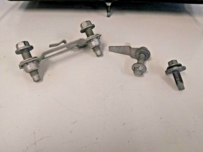

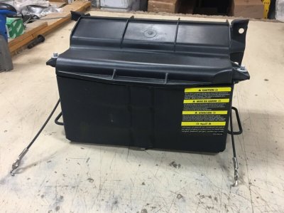

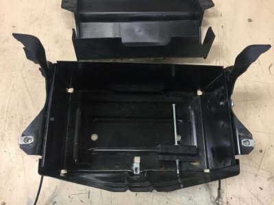

So it's a done deal. You have a few companies that are charging crazy prices for battery box and mounts. The factory one for the Econoline is perfect. It fits a group 65 battery which is 12.1"x7.5"x7.6" My battery that I'm mounting is a group 27 12.1"x6.8"x8.9". So the only issue will be the height which is easily manageable. Here is what I bought for $45:
Econoline Battery Box Lid 1.jpg Econoline Battery Box Lid 2.jpg Econoline Battery Box Lid 6.jpgEconoline Battery Box Bought 4.JPG
