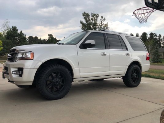

I’m running Bilstien 5100 because I wanted to lift it an inch, but you can get the same ride with 4600’s. They firm it up nicely and get rid of that float. I experienced the same thing in our 2015.
