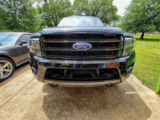

I'm not sure I should create a new thread or something for this but here is some close-ups I've been playing with different brands and setups since December... They are held on by a few tacks of hot glue/clamps and then siliconed in underneath, not inside the headlights.The bottom is looped around the indented cavity of the fog lights... Best thing being DRLs it's legal!!
I'm using the opt7 show glows. I've tried other's but these are worth the extra price.
Got a close up shot of that! That looks like something I would like to do!

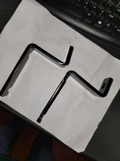

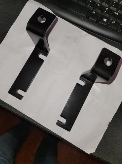

Numerous CCD Expys have been lifted. I haz pictures.
The ride height sensor arm must be put back in the factory location where it was before the lift. This is done by making, or my favorite; "purchasing", new longer sensor links that will accomplish this. Just so happens I know a guy....

We aren’t talking the Airbagged Expys, but the new Expeditions with the newer Electronically controlled dampeners.

Yes, I’ve seen 15+ that have CCD that install longer sensor arms and lift them just as non CCD 15+s would be lifted. Finding a good quality sensor arm is key though
