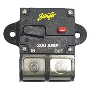

oh and dot forget a 200amp fuse box!! dont catch your bat on fire!

is that fuse necessary though? ive herd yes ive herd no. and thanks for those terminals. i could never find any. but i have extra wires and cable for my off road lights can i still attach them to it or no?

for me the cost of the fuse box out weighed the cost of a mishap. if it were to disconnect from the alt or the bat without the fuse box you are almost guaranteed a fire.... so its up to you. i have not had it disconnect and its been about 1.5 years now but i have it just encase. the off road lights i would splice and solder into the 0 gauge they will be given a better connection without affecting the sound system.

I would go with this instead of a fusebox, if it trips, you can reset it and not have to carry extra fuses.. I use a 150amp one in my stereo setup.

if the install is done perfect and you dont off road then id agree. the fuse is probs overkill.... but why risk it for a few extra bucks

I go off-roading but nothing toooo crazy, but then again, all my cabling is secured and wouldn't rattle loose and touch anything.
