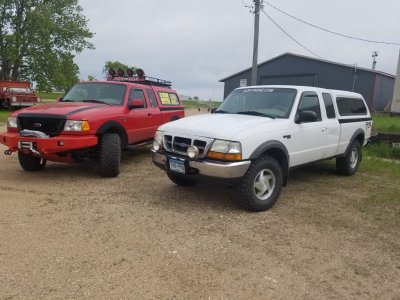

Ive got a white 98 ranger and a red 99 ranger. Both have the 3.0Ls, which many hate and many love. The red one is getting a 5.0L from an explorer soon. And im probably gonna sell the white one when i get this Expedition. The tranny is slipping when you first shift it into D or R in the mornings. Well not really slipping, but not wanting to engage fast..takes it longer to engage. Once its warmed up, it drives fine.

Side note about your transmission in your Ranger, a transmission fluid change would probably clear that right up. That sounds like old fluid that is thinning out, not moving the hydraulics as quickly as it should.

As for the Ranger, i will try changing out the tranny fluid. But i know the tranny has over 250-270k on it.

A lot of people will tell you with that many miles NOT TO CHANGE IT (in all caps like that) because it will CAUSE slipping, but what is actually happening is so much of the friction material has worn off into the fluid that the fluid is actually helping it maintain grip, sort of like a friction modifier. It only exposes this wear and probably would have started happening anyway in a few thousand more miles.

Yeah ive heard that too. Im just not sure what to do with it.
I rebuilt the 3.0L engine about 3 years ago.
Its just a winter beater really.
My red 99 is having a Turbine Input shaft sensor issue, not wanting to shift properly. And im done dumping money into that engine/tranny, so im working on rebuilding a 302 5.0L from an explorer for it.
