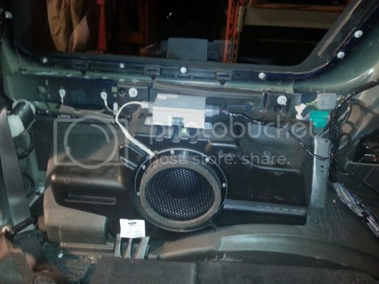

The only 2 reviews for the 3rd gen stealthbox on Crutchfield are 2nd gen owners that said with minimal modifications it'll fit. If the factory subwoofer enclosure is the same from 2nd to 3rd gens then I will hopefully have an answer as to whether or not the stealthbox will fit and will provide pictures in a couple different threads of the modifications required, if any.

I'll take a picture of the plug on the amp tomorrow. The two problems that I see just looking at your pictures are that it does not appear that you have the factory mounting studs and the tray that you have the tape measure next to needs to be replaced with the shallower version.

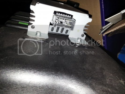

Here is the picture of the plug on the amp. My harness for the amp was taped up and run along with the harness going to the C pillar. If you have it, you probably won't know for sure until you pull the radio or the rear panels. In my experience, if the vehicle wasn't optioned with something... Ford wasn't usually nice enough to leave the wiring there for it.
Remember that you'll also have to make a hole for the sound.
On the top picture I posted you can see a purple wire, blue wire, green/black wire, and I believe yellow/black wire in a connector that presently isn't used. I was wondering if that was the harness for a subwoofer??? I see that the plug on your amp is different than the plug I have above. Did you not have this empty plug at all? What are the colors of the wires going to your amp?
From what I can see in your pics here it looks like you don't even have this empty connector??? I wonder if I just need some short harness though because it seems like the wire colors may be the same. In your 4th picture down I see purple, blue, and green going to that amp.
