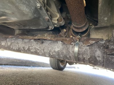

There is a heatshield on the cross connect pipe that is rattling. Had the exact same sound at just below 30mph. Driving through traffic let off a bit then back on.."braaap".

Anyone find out what the problem was? I have the exact same noise at the exact same RPMs. And it’s not my Heat shield rattling
