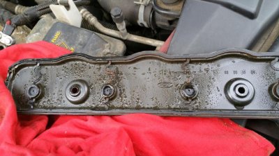

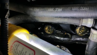

If you notice oil in the spark plug well, this is due to a Spark Plug "O" ring gasket gone bad inside your valve cover. it needs to be replace.
This could also be a reason why your building up moisture in there as well. Oil and Moisture from your valve cover could be escaping through your leaking gasket and filling up under the coil cover.
I would also make sure your lower intake is not leaking coolant, i have heard it also can drain into your spark plug well.
Check also above the Coil Cover to make sure any of the cooling hoses is not leaking as well.
I had a misfire on coil #4. open it up and notice lots of moisture build up. i had also oil in several spark plug wells due to gasket gone bad.
I also confirmed to make sure it was not coolant in there as well.
i had to replace the all the gasket on both sides of the engine since the other side was leaking oil as well. I would recommend buying a Valve Cover gasket kit. that includes the Valve Cover gasket, Spark Plug "O" rings and bolt grommets. for both sides it cost me around 60 dollars. Hardest part is getting to the valve cover to replace.
after replacing coil packs, plugs and valve cover gaskets. No Oil leak , No Misfire and No Moisture.
