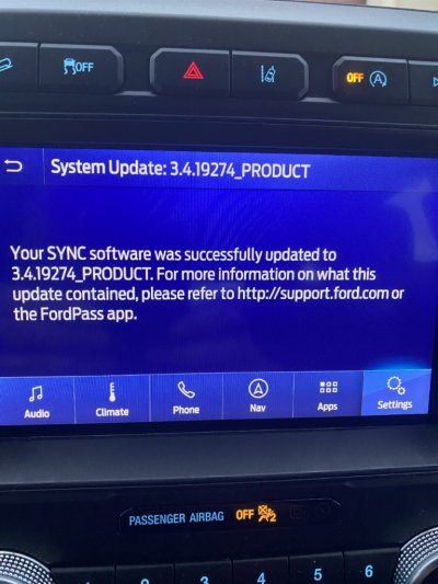

Go to ford.com and search sync update. You put in your info to login or register. There will be instructions on how to upgrade the firmware. You download to the computer, unzip the file, put everything on a thumb drive and put the thumb drive in one of the front usb slots, the system does the rest. Important that the rig stays engine running until the update is completed. Disable “auto engine off”. Takes about 40 minutes. Cycle vehicle completely off, restart and firmware is upgraded. The Ford site has pretty good instructions from how to download, set up the thumb drive, and what to expect when in the truck. Maps update is basically the same but the files take about 2 hours to download due to large size and about an hour with the motor running to transfer into the nav system from the thumb drive. I erased all other data from the thumb drive and had only the files ford stated on the thumb drive. Make sure you format the thumb drive to exFAT32, not “FAT32”.

When I did the bootleg update in my 16. I was never able to get it to upload to SMR or auto update after the install. Tech told me it was because my unit was never allowed this update by Ford officially. But if you had a later 17’ they rolled out an official update for CarPlay. Maybe this will be the same until Sync my ride says we can update, if at all. I have a early build 19’ with 3.0 sync. Updating right now. Fingers are crossed.

Got it to work!!! Now I need to get the Forscan program and hub. I want the Lincoln screen. Thanks.

3.4 can be done on any Sync 3 system without doing the Firmware or having a new APIM using the Format Tool.
This is the process you should be following and files you should be downloading.
https://cyanlabs.net/tutorials/update-ford-sync-3-2-2-3-0-to-version-3-4-all-years-3-4-19200/
I am up to 9 systems now. 2(My 16 Edge, and My 17 Expy) were done prepping all the files manually several Months ago. The other 7 using the AIO’s from Cyan Labs. I highly suggest going to 3.4 19274 after going to 3.4. It is FAR less buggy.
Just to be clear, there is a risk of bricking your APIM, and this is AT YOUR OWN RISK.

This will not work unless owner.ford.com shows you as needing to update, or upgrade pending.
You can do the check for update via WiFi and it will also check in and submit the version. Not sure how Ford’s system is going to handle the version being higher than it is officially released to be at, only time will tell.
