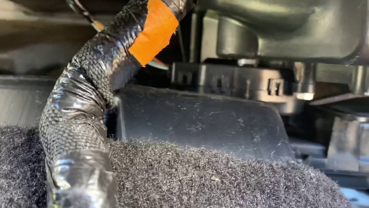

Two; there’s not a single video or forum thread that I can find that clearly states, depicts, illustrates, shows, or even talks about where the driver side blend door actuator is on a third gen, specifically a 2015 expedition. A 2008 is SOoo different than a 2015. The dashes don’t even look similar. Am I missing something? Thank you in advance! Please lemme know!!!
WHERE IS IT!?!? Ugh!

I’d still like to find a video that shows the ACTUAL location of this blend door on a 2015 expedition. Thanks
