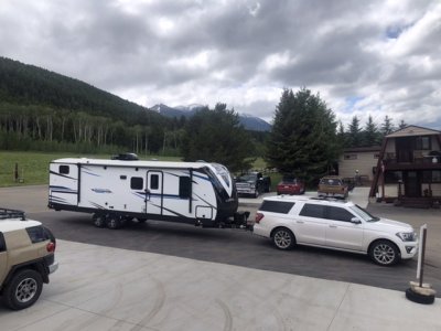

Brand new (holdover) 2019 Expedition Limited 4WD owner. I tried ...and tried ...and tried to convince my wife that she could handle a Ford Expedition (she drives a '16 Honda Pilot now). But the additional size/bulk of it was beyond her limit. (Her preferred vehicle size is like Honda CRV / Suburu Outback size). Sooooo, after a LOT of hand-wringing, I sold my old Chevy Duramax 2500HD and as such, the Expy is now our new tow vehicle for our '19 Jayco 26' camper. It has a GVWR of 6100#.
My Limited has the heavy-tow package and before I even knew it was required, I purchased a Husky Center-Line TS WDH (apparently handles sway control as well). I've researched it a ton and this was the most recommended WDH from most of the RV'ing community and dealer network. (I bought the 800-1200# version, model #32218). Well, maiden voyage with that will be this coming weekend, when we go camping to around 7200' elevation. I will report back on my experiences.

that will be interesting for sure

Welcome aboard!!! Great pics of the Expi and camper. We are thinking of getting a camper. We have been watching a show where they give a buyer three options and they buy one. My wife wants a class A diesel pusher .... I want a travel trailer. (I hope I win)
