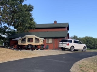

Just did 4 days to Yosemite. Stayed outside the park on Family property. Don’t laugh I tow a 4x6 Life Time Tent Trailer. Loaded we typically run 1300lbs with a heavy tongue weight typically 190lbs ish pending what were taking with us. This trip was 4 adult sized bikes and my heavy vertical hitch rack strapped down to the trailer with the bikes fork clamped to the trailer and some other gear like camp chairs 10x10 awning etc.
I have towed this trailer with our 2010 Outback, 2007 Sequoia also.
First trip with the Expedition. Quick reference the Outback in this exact gear setup typically ran 18-19mpg trip averages. The Sequoia 14-16mpg
The Expedition no joke posted 21mpg after 3.5 hours to our camp spot 65-70mph! All our day trips up to the park no trailer we ran 21-22mpg trip home 3hours also 21mpg.
We are talking about upgrading the trailer slightly. Something like the Taxa Mantis which might be 3200lbs loaded.
Yes I have the Heavy tow pack and I know these are small trailers but I like going places where the huge RVs typically can’t go.
Speeds? Its all dependent on the trailer stability which is typically aerodynamics related. My sleek, lifting keel, closed deck racing sailboat towed amazing even at 26ft hitch to stern. It crossed NV,Utah,MO at 75-85mph without so much as a wobble. Same for my 4x6. But a big giant box yeah 65mph especially in windy locations is typically maxed out on stability for most properly weighted RV trailers.
The Taxa Mantis would fit my garage, tow far nicer than say a 19ft Baja bunk house.

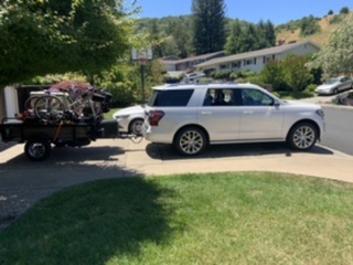

Here is my setup before getting the WDH really dialed in and adding coil sumpsprings in the rear which results in the Expedition having zero squat.66b34db32fcb07ac0830bf1aefcab421.jpg
