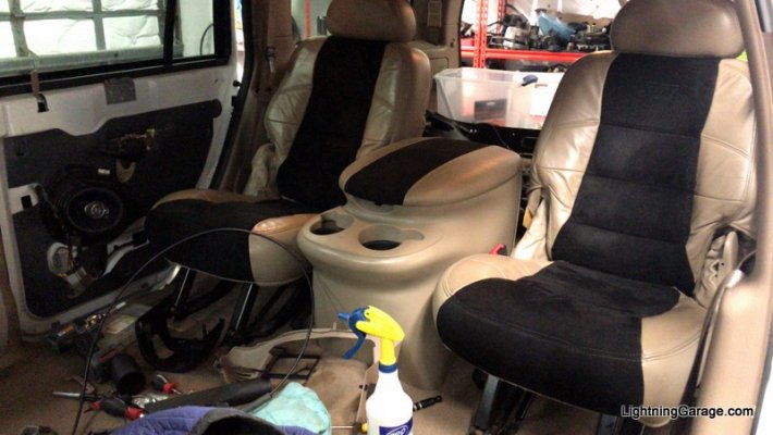

So now the buckets and rear console go in, I still need to finalize the console brackets and put the trim pieces in, but it looks fantastic so far. Can't wait to do the front seats to match! Thanks to Chris for the great looking seats and Danny for the OEM level installation of the floor latches, it works just how Ford intended. I figured if Ford had ever sold a "Thunder", like the SVTs of the time it would only come fully loaded (my 03 Lightning literally only had 1 option, a tonneau cover). In my imagination this meant it needed to have rear captains and a console as would befit either the "mommy missile" or "executive express" it might be for buyers.

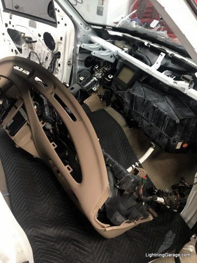

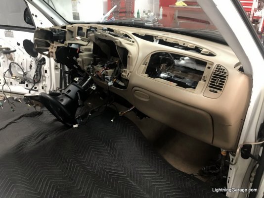

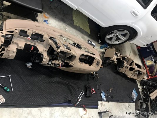

I knew the engine swap was going to be involved, and I wanted to give myself the time and space to do it right.... (famous last words as little did I realize just how involved, a couple of curveballs thrown my way changed everything), so I distracted myself with a little bit of interior upgrades for the time being.

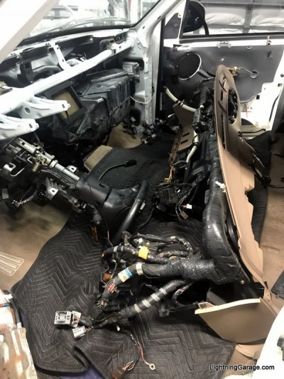

I knew that I wanted to follow the example the concept SVT Thunder set in using the Lightning interior bits.... and the school bus steering wheel in old man tan sticks out bigtime...
While the recovered Lightning buckets, smaller 4 spoke steering wheel, and the black trim on the dash and console gave the Thunder concept a much much better look.

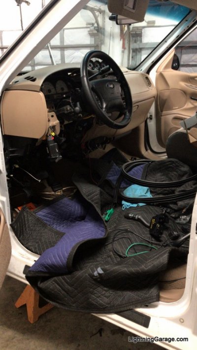

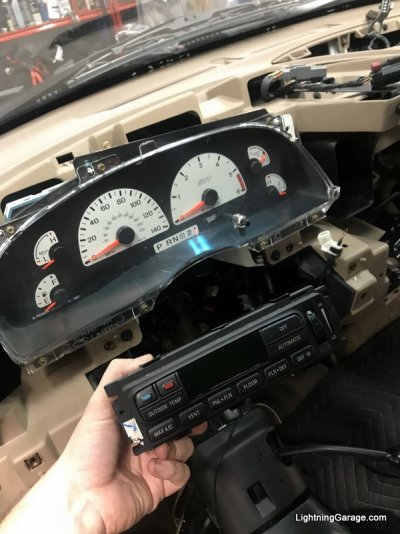

So I raided my bin of leftover Lightning parts and first to go was the steering wheel. bye bye!
Test fit looks good, but we can do more while we're here.
Let's get the cluster out and give it some contrast!
Forgive my eagerness to add a little bit of flair on there, I know it's a shameless upbadge!
Cluster back in, and while you're in that far might as well take care of some other stuff...
Added a black cluster surround that holds some of the speedhut gauges we saw earlier.... much better already
While it was all apart I added a Sony XAV AX100 headunit, which ruins the other gauge pod I had on hand, but does let me add carplay and a backup camera to keep all the conveniences you'd expect today.
Wheel is back on
and now one of my favorite tricks, airbag from a Ranger/Explorer fits and has a metal Ford emblem instead of just the embossed Ford logo in the plastic. Just feels like the right way to cap it off.
The original wheel from my 2003 Lightning was on there, and it's real nice.... but I had gotten used to the nice heft of a slightly thicker wheel like the custom thicker one with suede and leather I had made for my Lightning. I didn't want to go that far down the rabbit hole here though, so I used a leather wheel wrap kit to give it some more thickness and have both smooth and perforated sections like the Cobra and FR500 mustang wheels.
For my first time ever trying something like this, I was pretty happy with my work.
I hid all my ugly stuff in the back
Looks like nearly a brand new wheel about to go on
And now I'm really thrilled with the outcome

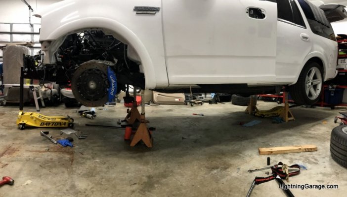

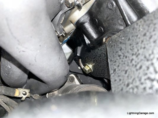

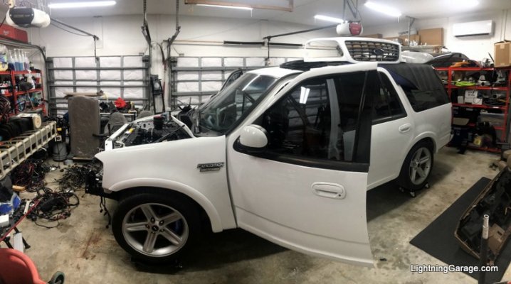

So, the thing that finally pushed me over the edge into doing the heavy work and getting the motor in? AC in the garage!
After about a 20 point turn to get it perpendicular in the garage, the work could begin. The new motor sits nearby overseeing my progress and telling me it wants in!
Last ever view of the engine bay as it was... totally stock. I knew (mostly) what I wanted, so I was able to resist the temptation of adding anything I thought would end up being redone... no air intakes or other stuff like that...
Grill and bumper off to avoid any damage and make it easier to work on, fluids being drained...
Parts pile started to grow very quickly as things came off

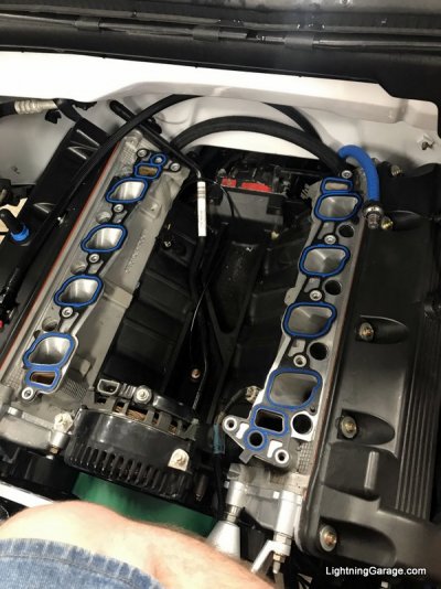

Intake is off and we're getting warmer

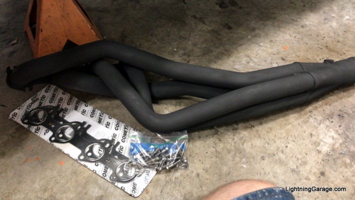

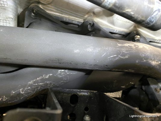

Headers out and they're looking a bit more seasoned this time around
Then after undoing the transmission, it was time to say goodbye
Other than the dirt, they don't look very different at a glance... but can't wait to see how different it'll run!
